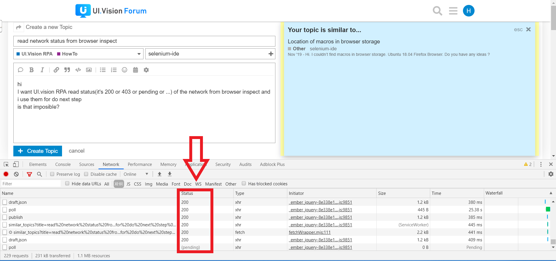

hi
I want UI.vision RPA read status(it’s 200 or 403 or pending or …) of the network from browser inspect and i use them for do next step
is that imposible?

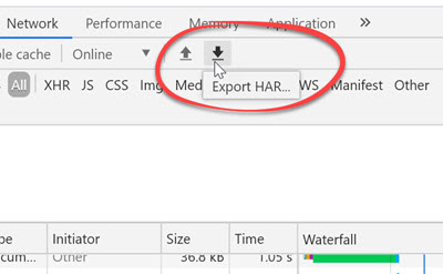

Chrome has an extension API that might help:
Network requests information is represented in the HTTP Archive format ( HAR ). The description of HAR is outside of scope of this document, please refer to HAR v1.2 Specification.
More details here:
This would give you the same information as the “Export HAR” icon in developer tools. Workaround fo now: If that info helps you, you can automate the export already now as a series of keystrokes with XTYPE.

in Some sites that have a lot of Ajax when site is very busy ajax requests not work correctly.
When I click and send a request, I can find out through Network requests information that I have to wait or click again.
I think just Direct access can solve this problem.

So to download the HAR file, the keystrokes would be first F12 to open the developer tools. What keystroke would we use next to get the har file? Wouldn’t we require to do Xclick on the download button?
The keystroke sequence and clicks are the same as you would need manually. Yes, for desktop buttons you need to use XClick.
