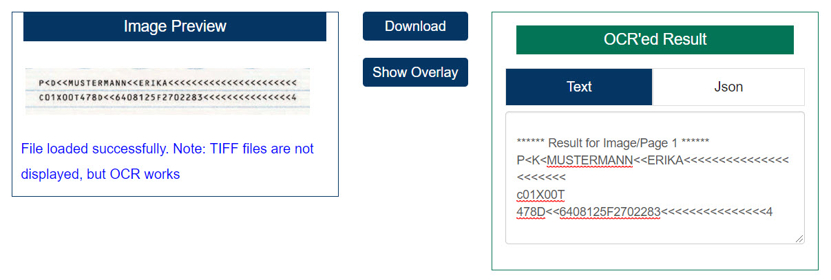

When scanning alphanumerical texts like the MRZ it often helps to select Korean, Japanese or Chinese as OCR language. For the MRZ font, Japanese gives the best results in my tests. (For other readers: MRZ = Machine Readable Zone, at the bottom of the identity page at the beginning of a passport).
Test input: Machine Readable Travel Documents – Wikipedia
Result: See below - Is this result good enough for your use case?

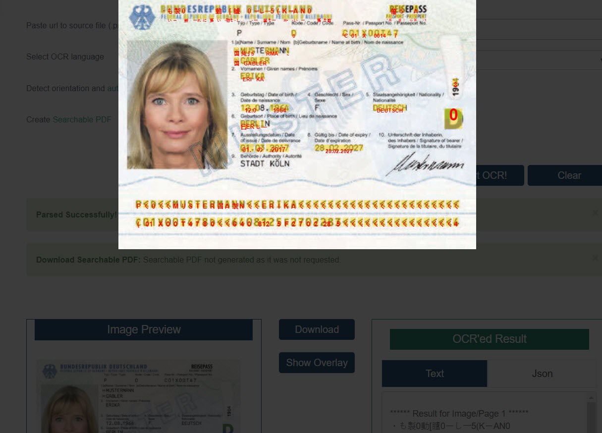

:fearful: Really?? I haven’t tested with that languages, so I’ll try first… Because with this response is not good enough and I don’t know if we can make any transliteration…
Thanks!
