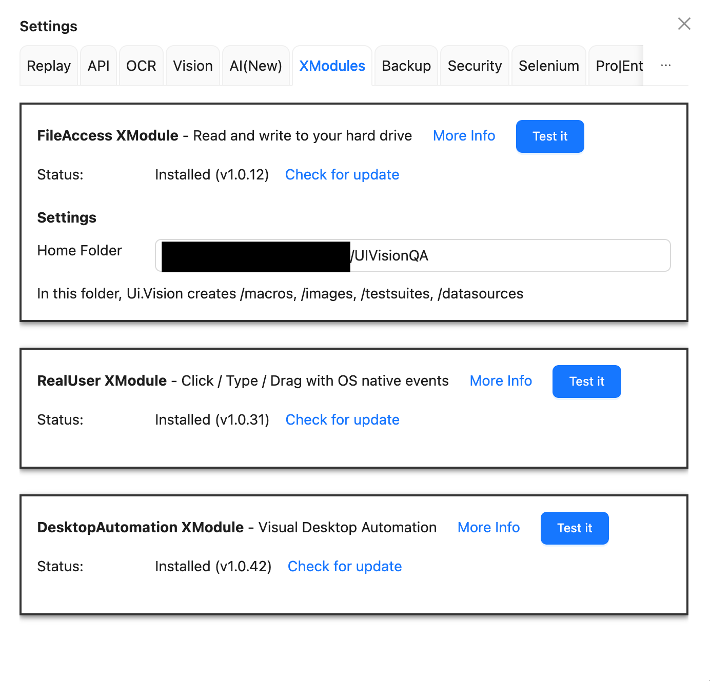

I think it is a permission issue. As a first test, can you please post a screenshot of the Ui.Vision XModule page?
Thank you. Please find the attached screenshots. No matter how many times I am installing I still see the ScreenCapture XModule as Not Installed. @admin let me know if there is any other additional details needed.
