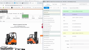

Thank you. That does not seem to work for me. Interestingly, the screen recorder I used does register that as a click. (if you can even see my crappy gif). So, it’s clicking in there but then not typing it would seem.

The screencast is very small… but it seems the date is filled in, or?
Yeah it is filled in by default but is not modifying with the dates I want. Sorry about the tiny gif, I have not made one of those before.
