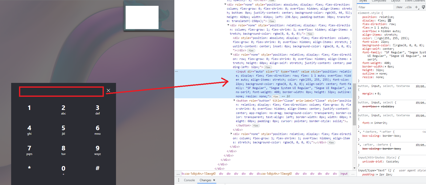

I’ve been struggling to click the keypad area of Skype Web version. I’ve done almost everything but I cannot type numbers on this area unless I use click on every digits that I want to press. Pressing Numpad keys on the keyboard works. I also tried using Xtype, it works but I have to manually click that area before executing the Xtype. Anyone? I’m a newbie and I’ll appreciate your help. Thank you!
try this
click box with XCLICK
then send keys with XTYPE
Thanks! I tried using XCLICK and it works. Only problem with Xclick is it’s messing with my mouse. just wondering how I can select it and type numbers without using my computer mouse. Anyway, I appreciate it.
Some elements work like that
try sending ctrl v but paste text to clipboard first
you can always move mouse again
