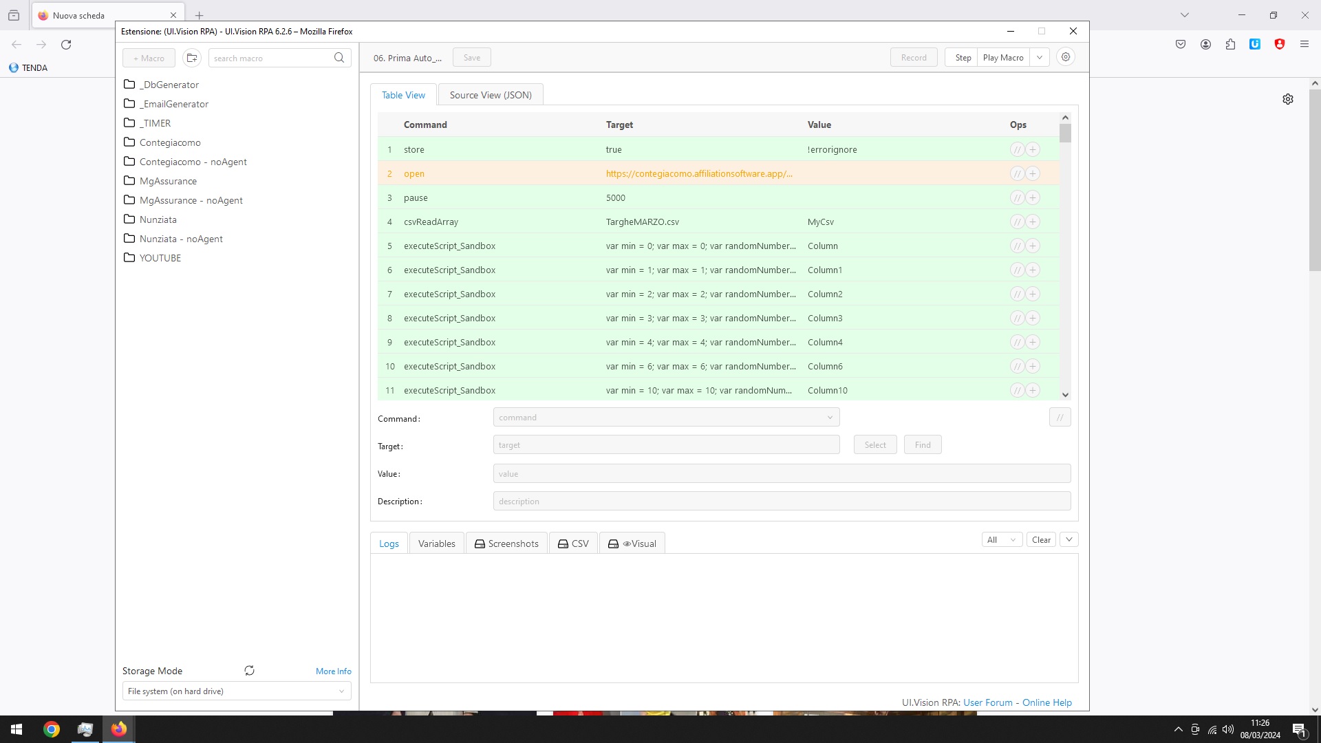

The "open" command not open the URL
I’ve been using ui.vision for years and only in the last 2 months am I having problems like this! Do you have any feedback?
Is there a test macro or screenshot? I have not seen such issue. I am on 9.0.5.
If you do not use !errorignore, what error message do you get?
Does this issue also happen with a macro on a public website (that you can share here)?
The problem has been occurring since the 9.0.6 update.
In fact I have another machine on which the version is 9.0.1 and everything works correctly.
I’m imagining doing a downgrade
  • If I use !errorignore, it doesn’t open the link, after 10 seconds it closes the macro
  • This problem also occurs when opening the Google home page
I created this test macro and it works for me. => Does it work for you?
Having said this, I think there is indeed an issue because another user reported the same.

The “open” command not open the URL
=> Well, you told me the OPEN command does not work. Or did i misunderstand the issue?
Up to version 9.0.1 the links ALWAYS open.
With the next version the same code sometimes opens links and sometimes doesn’t.
For no apparent reason!
Another Uuser also reported this to you…
Also OFTEN does not read or CSV!
This is most common when we put macros in loops in the folder.
I hope you understand now
As I told you, I’m imagining moving to version 9.0.1.
How do I block automatic updating?
I wouldn’t want it to automatically update to version 9.0.5 and have the same problem again
