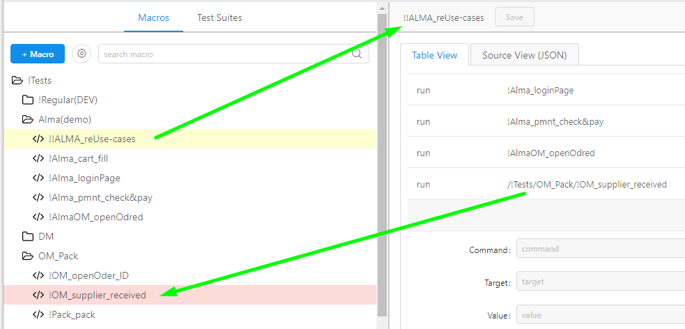

I used absolute in this case:
And thanks to Admin for clarifications, now it works!

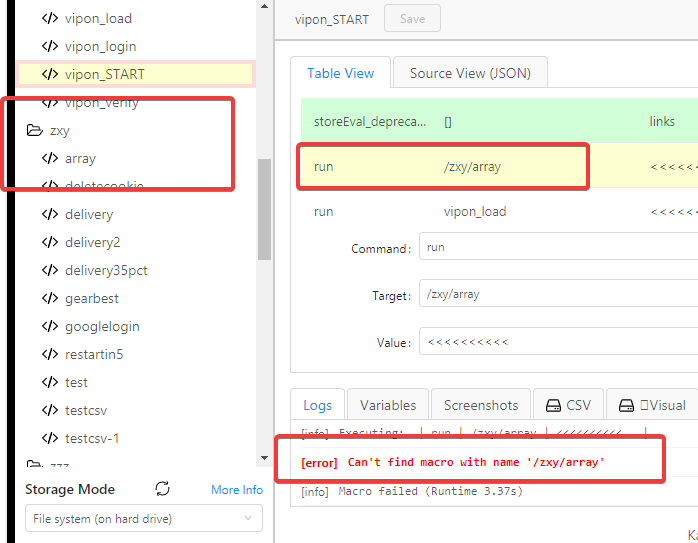

Does not work for me ((
@commensal => Ah, it seems you are using hard drive mode! I will re-test this ASAP.

I am having the same issue. I am using hard drive mode and have moved macros into categorized folders but cannot get the Run command to play them. I have tried both absolute and relative methods to target them.
I confirmed the RUN problem in hard drive mode (issue #577). It will be fixed ASAP (this week).
