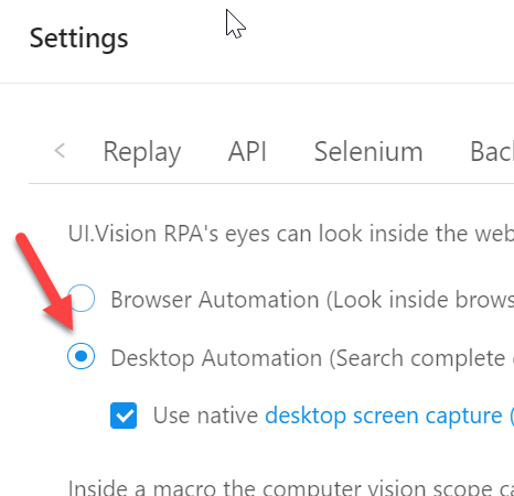

You have two options:
(1) Switch the global setting to desktop automation. If you only do desktop automation, that is the best option:
(2) Or, if you do web automation plus a bit of desktop automation (like me), then use XDesktopAutomation | true in all your desktop automation macros
