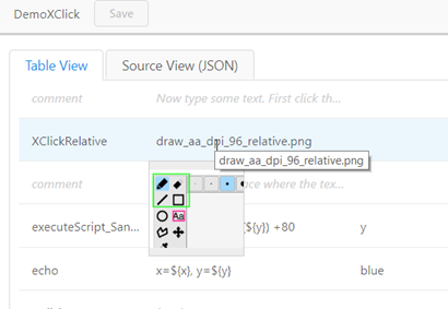

Second method: Use XClickRelative
Here the input image has a green box and a pink box. UI.Vision finds the image inside the green box, but then clicks in the middle of the pink box. See here: XClick and XMove - Real User Mouse Click Event Simulation, Robotic Process Automation (RPA)
Example: DemoXClick uses this method to click on the “Aa” icon. Since this icon is so small, it finds the area in the green box instead, this makes the macro more stable.
This method works only with image search, but not with XClick (ocr=text).
