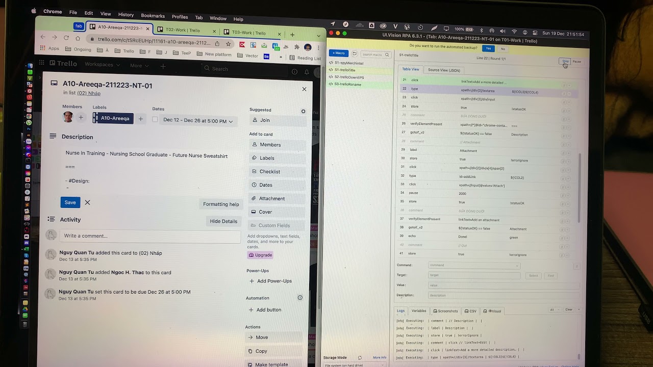

You can see it right here.
I even have a !timout_wait command like this:
And when it comes to the command that needs checking,such as verifyText, verifyElementPresent, and some click command under store | true | !errorIgnore; it doesn’t show the waiting time as usual.
Something must be happened with the new version.
New update @admin
So I don’t know what is the problem here. But this does affect to my workflow, since I can’t just abandon my old Chrome Profile, and my old Trello account like that.
Please help me, thank you a lot!
