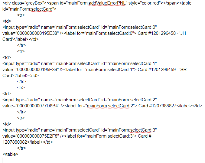

The segment of the page I am working with:
Card #1201296458 - 'JH Card'
Card #1201296459 - 'SR Card'
Card #1207988827
Card #1207860082
QUESTION: What is the proper xpath syntax?
Sorry, image of the segment of the page I am working on:
SOLUTION:
xpath=//tr[contains(*,"${!COL1}")]//input
The missing parts were the double quotes surrounding ${!COL1}
