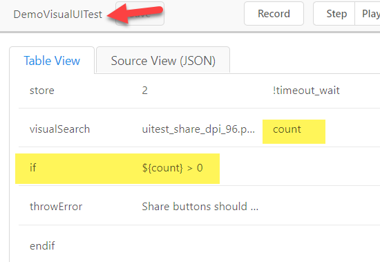

Another option is to use VisualSearch like done in DemoVisualUITest:
