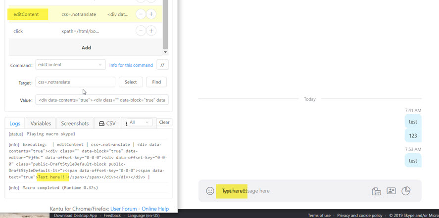

Because when I use edit Content it enters the text, but the Web UI of Skype gets confused and the “Send” icon does not appear. => Exactly the same in kantu and side2.
But what works great is to use XClick/XType (only available in kantu) to enter the text - then all works just fine.
editContent method (fails for me in kantu, side and katalon)
xtype method - works ![]()
Note that before XType you first need to do an
XClick | locator to set the focus on the input area of skype.
