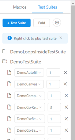

Or, you can combine several macros (= test cases) into one test suite:
