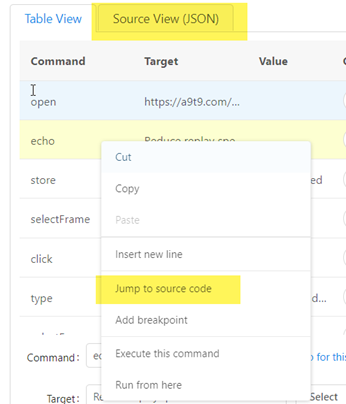

How can I move steps up or down?
Good question, here is how to rearrange commands inside a Kantu macro:
Right now, the fastet way is to open the Source View Tab and then copy and paste the macro commands (= JSON list elements) as needed.
Soon we will also support drag & drop for commands in the table view editor.
Note that you can jump directly to the right place in the JSON code. For this, use the right-click context menu and select “Jump to source code”:
