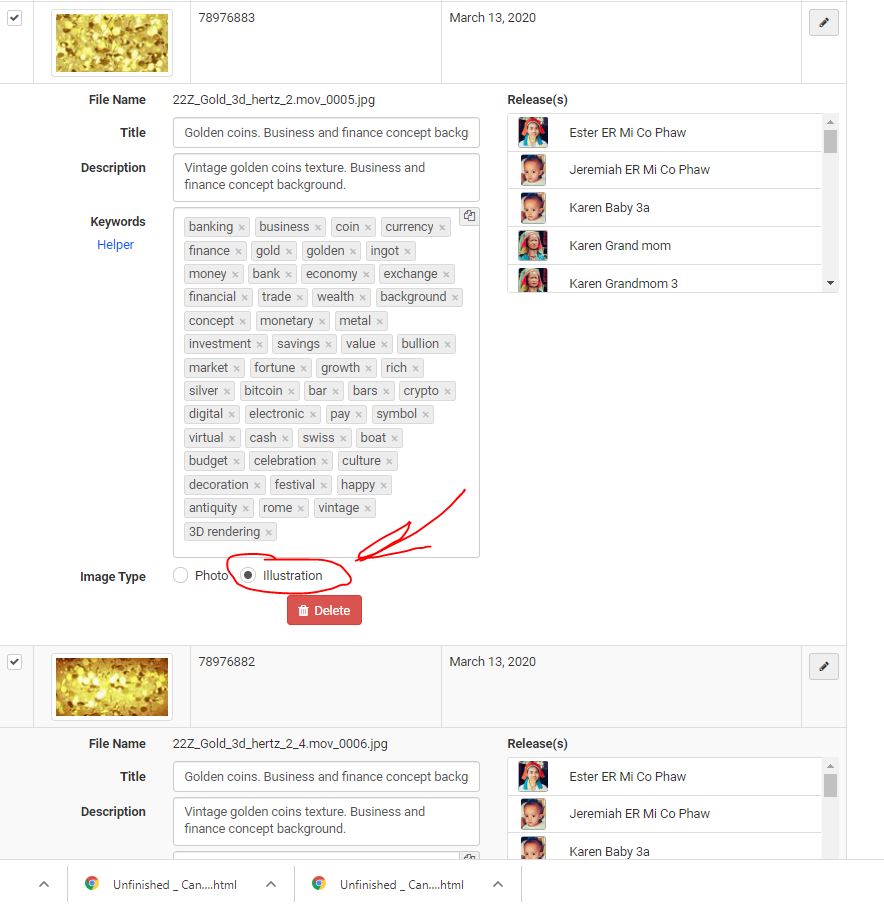

Hello.
I need to find the same caption “Illustration” on the page one by one, and click on each.
I made this record.
Please help me make a loop, I have more than a hundred buttons on the page.

Here solution to detect element that changing, your is a simple case
Thank you, this partially helped, but when repeating this code it finds only the first button over and over again. How to make him look for the next?

Post url page page i need to see the button and i create for you the code
Thanks for the offer of help, I really appreciate it, but this page is locked by authorization. I can copy the code from chrome.

These are the alternatives xpath available, latest xpath have not dynamic element and is more easy to detect.
none of the methods I found to scroll down this page worked … This prevented me from using xpath
This is the macro code to click is based on fixed xpath
I can not try online because i have no access to online page but if do not work the code try to increment this value [2] to [3] or [4] for every loop try to increment but i think this value can be fixed to [2] (I can not try online the macro code).

This is the image of ui vision the detect element
I wrote that this will not work. I have already tried. Only one button with an illustration is visible on the page, and swiping down does not work

In the saved page I see an auto refresh this can be the problem, because saved page load always and refresh.
If the page continue to refresh ui vision can not work, need a fully loaded page url.
I’m sure refresh can be disabled, this will help
If you disable autorefresh my macro code working well.
