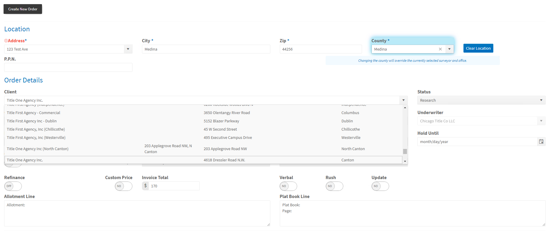

Please see image below of what the dropdown boxes look like. Sometimes there are multiple dropdown boxes open at one time.

A second issue, that only appears when executing the macro form the command line is that some of the text entered is also not “committed” to the fields. In the image above you will see that the word “Address” is red, indicating that there is “no” data entered yet you can see it is there, this randomly happens to any of the fields.
