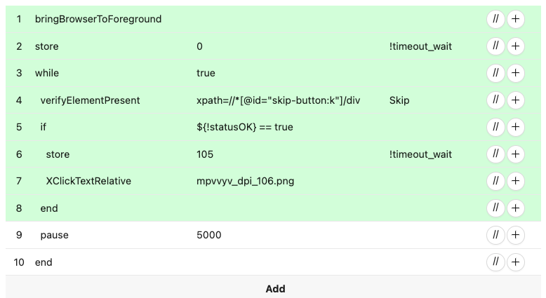

Here’s a screen capture of the macro in question. I think this is easier to comprehend than its XML:
It seems to be correctly identifying the text I’m seeking, which is “Skip”. There are two targets IDed, each with its own confidence number, and the higher of the two is the correct match I’m seeking:
0.74 #1 is Skip, and 0.64 #2 is Spon. Since I’m stepping through the macro, it stops on step number 8, on the desired discovery of the desired text.
However, I was expecting it to have clicked the spot—it didn’t send a click. Was I supposed to have declared the type of click desired: left, right, single, double? Was it NOT clicked because it the macro was being stepped through? Did it not click because there were two possible results offered and needs a confirmation first, before it goes and does its own clicking?
